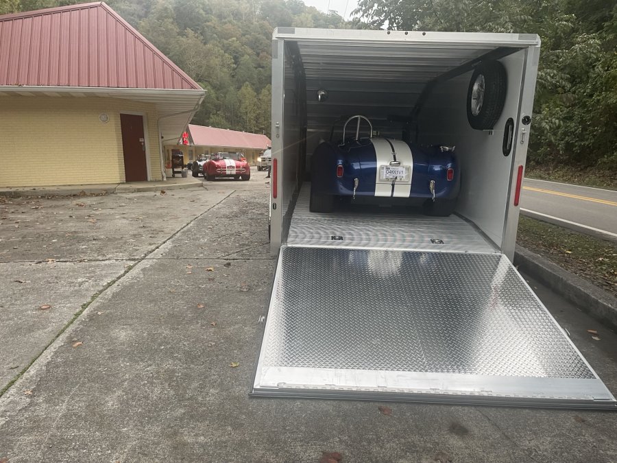

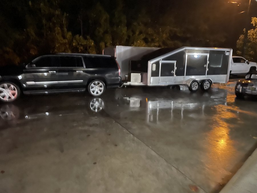

I bought an 18 ft. Serpent Express last month and trailered SPO3816 from New Orleans to Gilbert WV and back behind my Escalade. Because of the torsion axles and being so light, you must level the trailer and adjust your trailer ball height to it or when empty it will want to trailer steer on you. I also had to move the car around a few times to find the sweet spot, but once done, it pulled like a dream. I decided to go with the 18 ft. and glad I did, that 2 extra foot is nice to have.

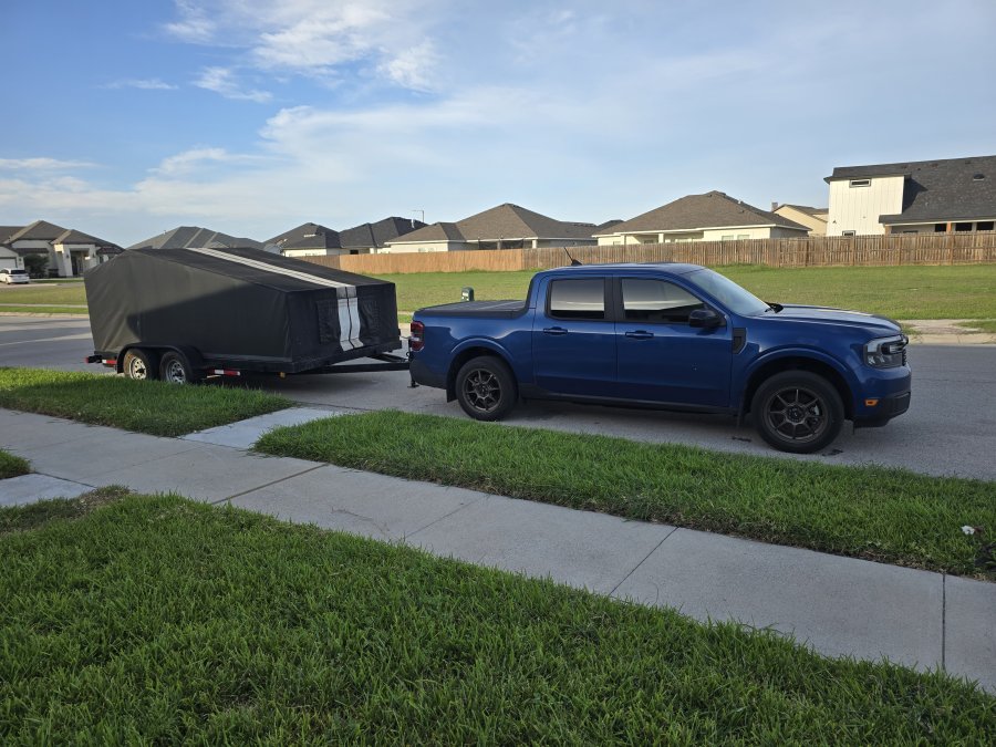

I have a 14' Canvas side that I bought this summer used. I feel like I got a good deal at 4K and it pulls like a dream. I don't even know it's back there pulling it with an '23 F-150 EB.
This picture is me pulling it with my Maverick before I traded it in.
