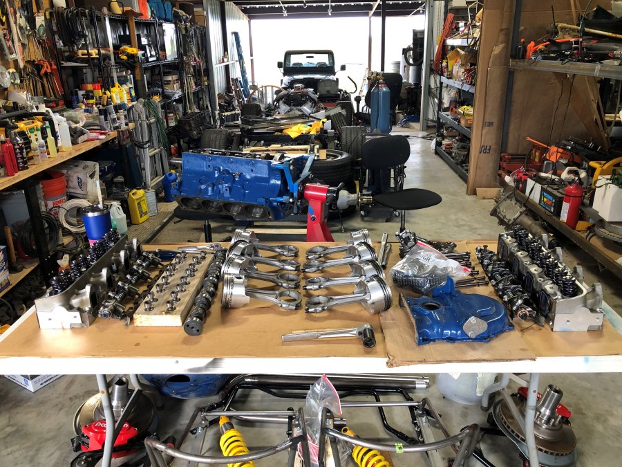

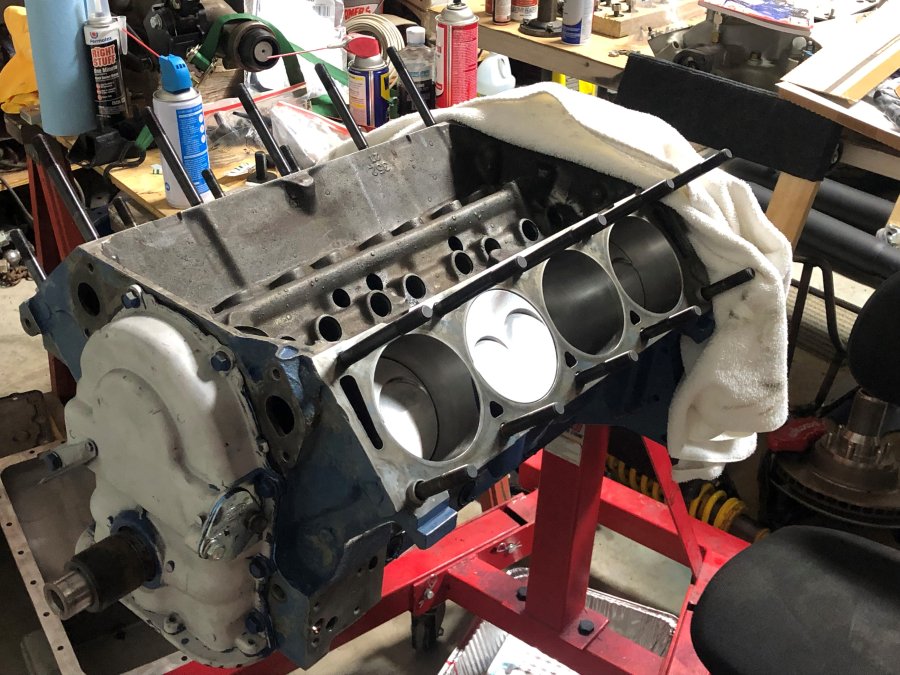

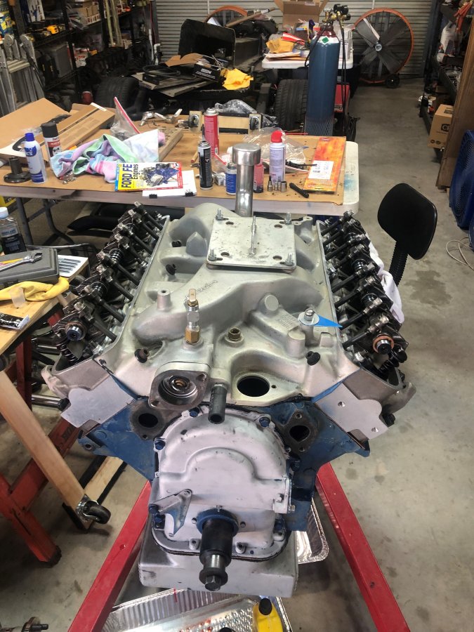

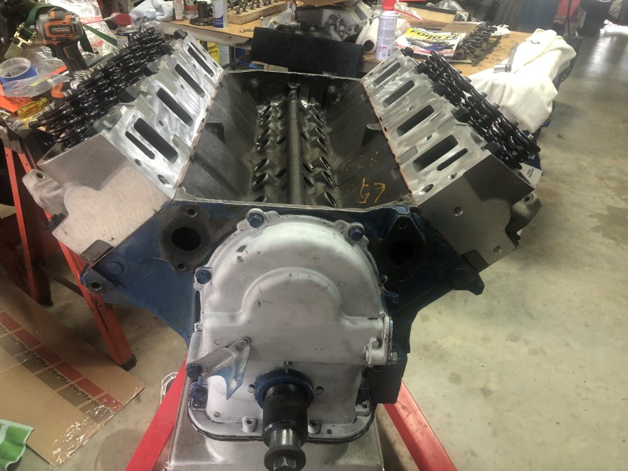

So I found an adapter plate for the oil system, so the only thing left on it is to get Peter to make my lines. I had to get some block work and crank work done. I had to get crank polished and water jackets soda blasted. I had to order new mains as it appeared something damaged #1 journal and bearing. So I have been taking my time putting it back together as temperatures have been outrageous. Next up is getting a few things powder coated so I can measure clearances on new clutch system. My steering wheel finally arrive from UK so that finishes steering system. I am waiting on cooler weather to bond body to frame and get it properly mounted. I thought some of you might like to see some pictures.

Found something new out, the oil galley plugs on a 427 are special ford threads. I now have one on order as one went missing at machine shop.

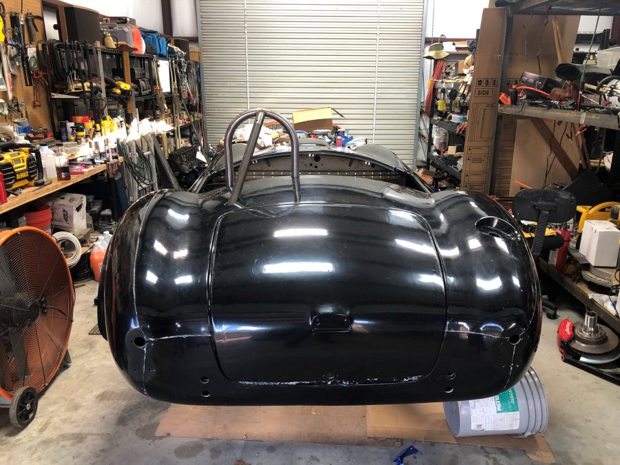

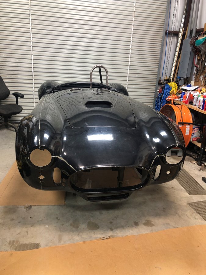

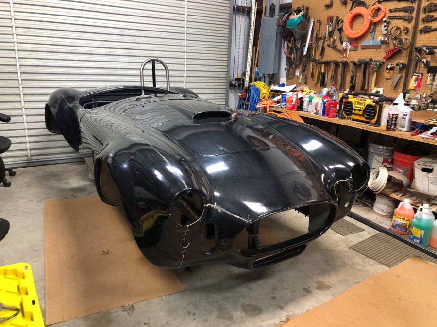

So I finally got the chassis all done and back from powder coating with the assemble all done and everything torn off we got started on putting together panels, floors pans and foot boxes. A group of about six of us then grabbed the body set it on the chassis and finished installing it. Now that the body is on I am waiting on my paint guy to move into his new shop. He said mid March he will start on the body work. So my next question is who has done a recent registration on a assembled car and how did you license it.
